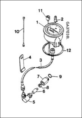

le compte tour c'est ref : 3140723R91
PRODUCT INFORMATION ,FIND RELATED ASSEMBLIES ,DESCRIPTION
PART NUMBER = 3140723R91
PACKAGE QUANTITY 1
FITMENT
This part fits the following models:
1046 - INTERNATIONAL DIESEL TRACTOR (01/75 - 12/79)
1246 - INTERNATIONAL DIESEL TRACTOR (01/73 - 12/81)
946 - INTERNATIONAL DIESEL TRACTOR (01/71 - 12/79)
PACKAGE QUANTITY 1
FITMENT
